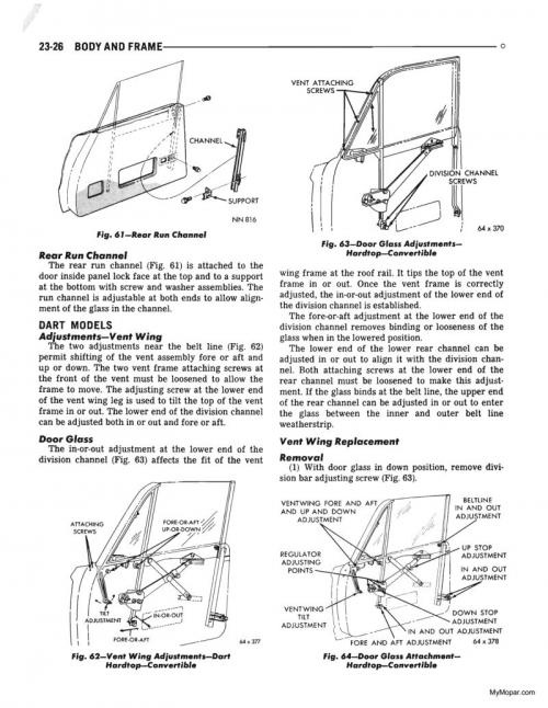

but if you really want to here it is from the 66 dart service manual.
sounds easy and it is, just the alignment is a b#tch
GLASS REPLACEMENT
Removal and remove glass from run channels.
(1) Loosen window track adjusting nuts (these are on the latch end of the door )
(2) Remove regulator arm from lift bracket channel (that's the welded track you can feel the regulator arm is hooked to on the inner door structure)
(3) Remove glass from door. (duh)
(4) Remove lift bracket from glass. (you can pry it out of the holes using a PLASTIC wedge or tool)
Before installing glass, lubricate all moving parts of the regulator
(1) Install lift bracket on glass.
~(2) Position glass into door opening.
(3) Install regulator arm roller into channel of glass
(4) Position glass into run channels.
(5) Adjust door glass. (this is the time consuming process.)
/nstallation
regulator with lubriplate.
lift bracket.
hope this helps
