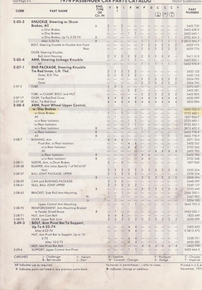

Parts book 1973 - A body spindle with drum brakes 3402739
47th Edition Hollander
812... part number 3722460-1 Hollander lists the 73 to 76 UCA interchange.

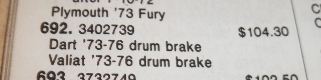

692... part number 3402739 Hollander lists the 73 to 76 spindle for drum brakes.

You are aware that "Casting numbers" are different than "Part Numbers" aren't you?
Anyway those casting numbers are 73-76 A Body Drum brake spindles.
I currently have 3 pairs of them out in the garage, and 2 pairs have good, readable numbers on them, same as yours.
So then, order your parts accordingly, nothing more to add.
