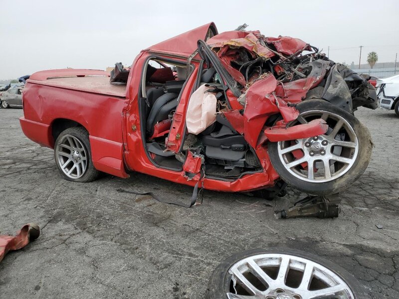

SRT 10 totaled

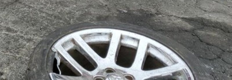

i find it fascinating that they took the wheel off and then put the lug nuts back on.
also, there' s bio hazard sticker on the... uhh... roof? i guess? so you know nothing bueno happened there.
What makes you think that someone took the wheel off?
There’s probably few good parts left from the truck.

Oh no... that wheel disintegrated I bet!

it's sitting right there in the 1st and 3rd pictures...
That wheel looks like it took a good hit, it’s missing a chunk. You can’t see the bolt holes in the wheels to be able to determine if the wheel broke under the lug nuts, but it does happen. After all it came off the side of the vehicle that took largest part of the hit.

Uhhhhh.....say WHAT? It's RIGHT THERE layin on the ground. Lug nut holes still intact so it didn't get ripped off, either. Someone removed it.
There’s no way you can can make a factual statement like that looking at this picture. It’s very possible that the wheel pulled over the lug nuts, I did collision work for over forty years and I’ve seen it happen many times.
No way? Well hoss, I MADE the statement. You have the right to disagree with it, but I MADE the statement.
It does look like there are bits of the wheel still on the hub.

If the wheel was ripped off, then WHY do the lug nuts appear PERFECT and NOT ONE wheel stud is bent or broken? There is also zero evidence of the lug nuts fragile metal covers being which THEY WOULD BE were they not removed by someone. Also, the lug nuts are backed off WAY more than they would be if the wheel was ripped off. That's because someone removed them, removed the wheel and then screwed the lug nuts back on a few threads. Lastly, the wheel shows zero scratches around the lug nut holes as WOULD be there had the wheel been ripped off. My guess is, if that happened, the WHOLE CENTER of the wheel would be gone. It's not and it looks remarkably intact from what we CAN see. I apologize for the blurriness. That's as sharp as I could make them blowing them up.
