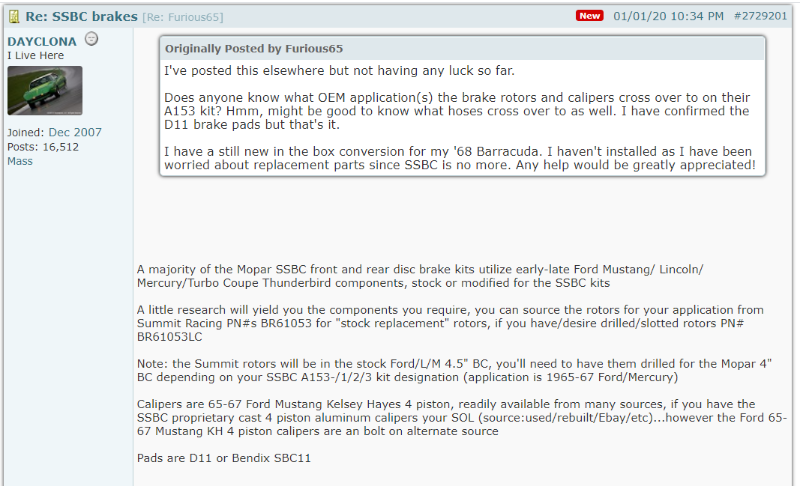

I put the SSBC kit on my '71 Dart GT about 20 years ago. So far I haven't needed any replacement parts, but I'm always looking for part numbers/information about the parts SSBC used (bearings, seals, hoses, etc...). If you @Shorty1029 can assist with part numbers it would be greatly appreciated.

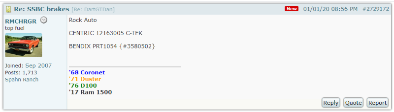

Here is what I've discovered (here on FABO):
So when looking for parts for these kits,
Inner bearing, 66 mustang and Mopar A body w 10 in drum (A6)
Outer 10 in drum Mopar and heavy
Duty ford mustang (A2)
Inner seal mustang National 6815
Calipers are all Kelsey Hayes parts. Mustang or Mopar A body. The only difference between the two is the location of the fluid port.
Rubber hose is the mustang hose as well.
While they are still available you may
Want to buy a pair of new calipers and store them.
Rotors are an SSBC custom machined part. You have to buy your rotor from them.
