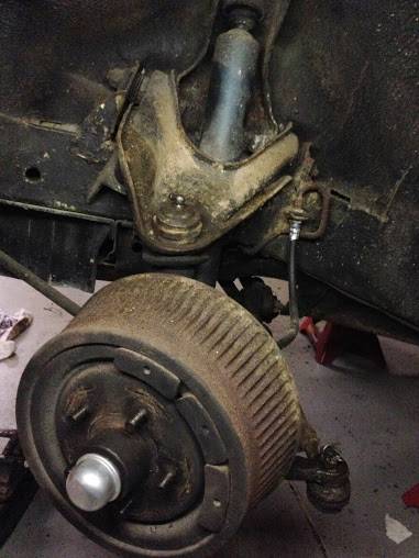

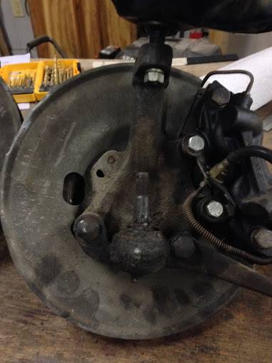

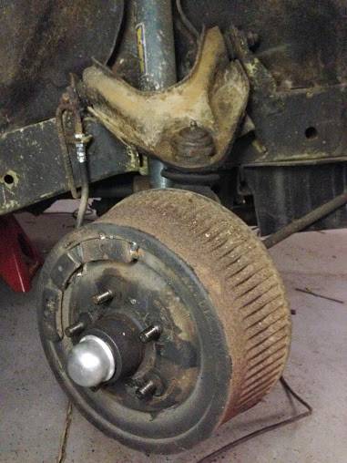

Here is what I had before the swap, 9” drums:

The first step was to remove my 9” drum brake stuff, spindles, and steering arms. There are three ball joints you will need to dissemble. Choose your method, I opted not to use a pickle fork. I loosen the nut, but leave it on to protect the threads, and then hit the joint hard with a heavy dead blow hammer. I used a jack under the lower control arm to take the tension off the spindle assembly. I reused the boots from my steering arm ball joints, but these are available (around $25 a piece). If you replace your upper ball joints you will need a special ball joint socket to remove the ball joint from the upper control arm, as it is threaded in. The best price I found for this tool is from p-s-t.com at $39 (sku:TOOLBJMOPA;free shipping).

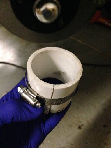

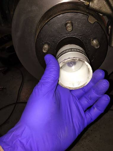

WHEEL BEARINGS
You probably want/need to replace the inner/outer wheel bearings and oil seal in the hub. If you need directions for this, do a forum search. Basically, I drove them in and out with a punch. I loaded the bearing with disk-break wheel bearing grease (check your grease, some is only for drum bearings). I slide the hub/rotor assembly onto my clean spindle and secured with new spindle nut and cotter pin.

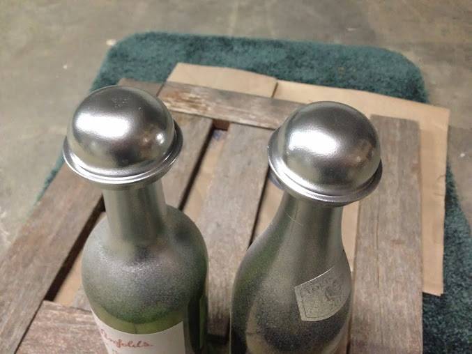

The dust cap is a very tight fit and since mine show through my wheels I wanted to install them without denting them up. I primed and then painted them with chrome color. Another FABO member posted a cool homemade tool for these dust cap installs; cut about a half-inch out of a 2” pvc pipe and then tighten it with a hose clamp. The cap fits inside the pipe and then I hit the pipe to drive in the dust cap. Here is what I used, but a FABO search will also tell you that Dorman part#618-101 fits too.

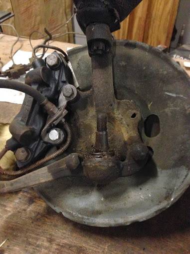

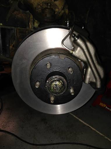

Next up is installing the new calipers. Before installing you will need to have the supply and cross-over hard lines. My Centric remanufactured calipers from rock auto came with steel cross-over lines but I bought stainless steel cross-over and supply lines from inlinetube. When you are shopping for donor parts, you should be aware that there is a special bracket that connects the rubber brake line to the hard caliper line. Another FABO member (davescuda) has reproduced these for sale (~$35), so if need them you are in luck.

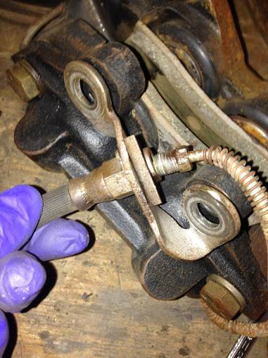

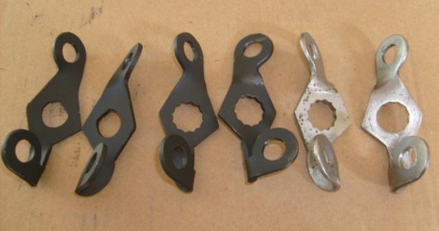

Here is a picture of one of the brackets:
I connected the hard line to the soft line via this bracket before installing the caliper. Installing the caliper would have been a challenge without a friend helping me. It is a heavy devise and threading the mounting bolts from the inside wasn’t exactly simple. It was helpful to have someone hold the weight of the caliper as I lines up the bolt hole. After installing the caliper, temporarily install the wheel and make sure your cross-over lines aren’t hitting the wheel.

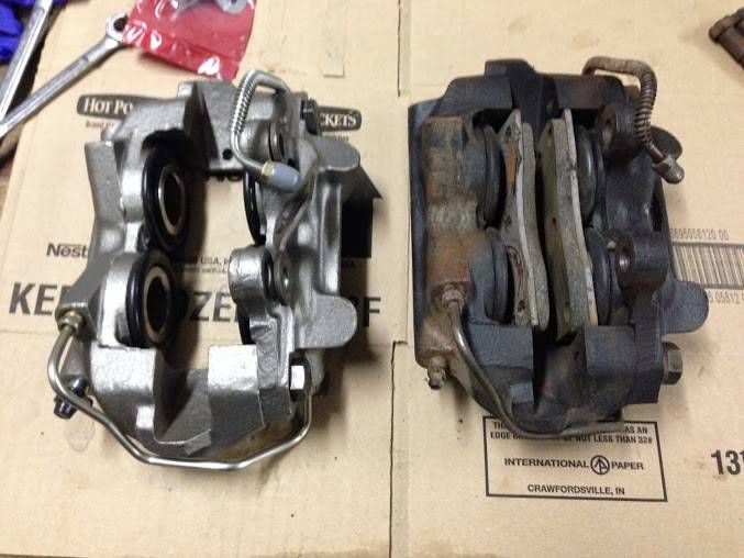

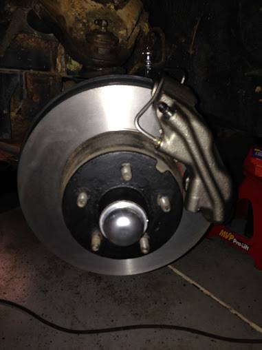

Here is a picture of my new and old calipers side by side:

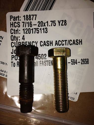

There are many people who ask about finding the appropriate bolts that hold the calipers to the spindle. I used a grade-8 7/16 – 20 1.75” bolt from Fastenal, part # below. You can search the forum and learn that some people believe the original bolt is very unique and worth it’s weight in gold. Consider yourself lucky if you have the original bolts (I think?).
Here is a picture of a stock bolt compared to a modern replacement.

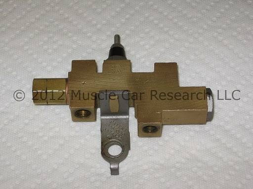

There are also a lot of questions about proportioning valves, search the forums for lots and lots of information. If your car was drum-drum you will have a distribution block that will need to be swapped out for a proportioning block.
The proportioning valve that came with my purchase was date stamped 1975, which would have been for a single piston caliper not the 4-piston caliper. It might not be perfect, but it works for me. I bought a rebuild kit, see below, and used it. Many people opt to use an after market adjustable proportioning valve from Jegs or Summit. I don’t doubt that they work better – but they also require replacing most/all of your brake lines.
Inlinetube.com sells reproduction Mopar proportioning valves. However, you are also likely to find a used one in the FABO community. Post a wanted add, they are available. The rebuild kit from muslcecarresaerch.com is $15, so consider that when weighing your option of buying a used to rebuild or a new from inlinetube.com, ebay, or jegs/summit.
I forgot to take a picture of my proportioning valve, but it looked just like this.

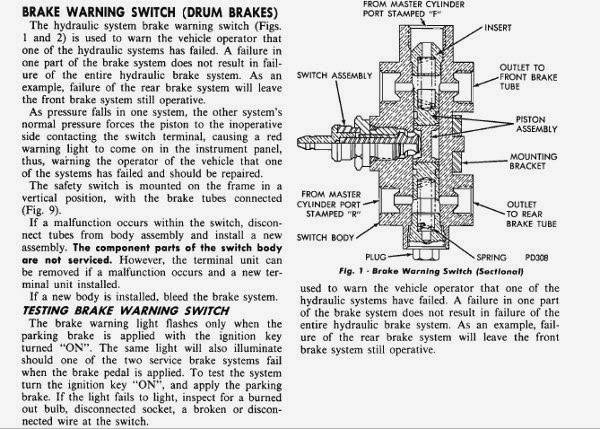

Here is a diagram of the proportioning valve, from the FSM. The red circle indicates a difference between the weatherhead and kelsey-hayes valve. Musclecarresearch.com will tell you all about it. They have a great thread about an "autopsy" (1970 - 1976 Mopar Combination Valve Autopsy | Muscle Car Research LLC) of one of these proportioning valves and step by step instructions on how to rebuild one with new seals.
And a pic of the distribution block diagram, from the FSM.

Those factory shouldered bolts that hold the caliper to the spindle have a shoulder for a reason. Those replacement bolts probably don't fit very snug in the caliper and may loosen up over time. Could be dangerous.
You might be correct. As they say, time will tell.
But I doubt it will be a problem. The caliper is very snug. If the two bolts are torqued to the same pressure, I'm not sure why the shoulder of the factory bolt would provide any additional fastening strength. I'm pretty obsessive when it comes to maintenance. I plan on putting a wrench on those bolts every time I do an oil change, maybe more frequently early on, just to be on the safe side.
I know this doesn't really matter, but I do know other people who have run replacement bolts for many years and not run into any problems.
As I mentioned in my original post, I'm aware that some people believe the original bolts are special and superior to modern replacements. They are obviously unique. There was a FABO member that indicated he was going to have these bolts remanufactured, but I think the cost was prohibitive.
I think most people are going to use the original bolt if they have access to it. However, if you have all the other parts but are missing these bolts, then I think using grade 8 bolts (and checking them regularly) is a reasonable alternative.
If someone has had experience with replacement bolts failing or causing safety problems, please post that information.
If someone has had positive experience with replacement bolts and have used them for a period of years, please post that information.
Going from the 10's to a disk, the LBJ mounting holes just went from 1/2 to 9/16. I drilled my drum ones out and they worked perfectly. I had just bought them but they are probably the same price as the disk LBJ's. The later 5 on 4.5 stuff had the larger upper ball joint. Good point on the stock combo valve. I used one too after I couldnt find my Summit adustable. Made plumbing that much easier, just had to bend a few tubes to make it work and I think I needed 2 adapters.
Hmm,I doubt it. Clamping force comes from the threads. If it's a real worry,could always sleeve the bolt for a snug fit.
I tend to worry more about the wear areas on the calipers,where the brake shoes slide. Those,if grooved can cause brakes to stick. Not a good thing.

Also if needed. Get these Brackets from davescuda or Jim's 70 Dart
35.00 pr shipped

Very useful post. Thanks for taking the time. I don't see a concern with using the grade 8 bolts instead of special "shoulder bolts" for 3 reasons:
1) I just replaced front pads on my 84 M-B 300D, which has a similar design - fixed caliper and rotor that bolts to inside of hub. Actually, a lesser design since 2 pistons (not 4) and solid rotor (not vented). Anyway, the 2 bolts that attach the caliper look like the ones you used. I didn't notice any special shoulder or tight fit in the caliper holes. Don't 73+ A-bodies have a caliper bracket that bolts to the spindle? Does it use special bolts? I recall my 2002 T&C is like that and has regular bolts.
2) Unless the factory bolt was a very tight fit, more like a tapered ball joint stud, I don't see how it would prevent radial play. They would still rely on the clamping tension providing interface friction.
3) The forces on a brake caliper are among the most predictable of any in a car. There are two limiters - when the pads slide on the rotor and when the tires slide on the road. A rough calculation gives <1000 lbf when the tires skid. That is trivial in the world of 7/16" bolts.
