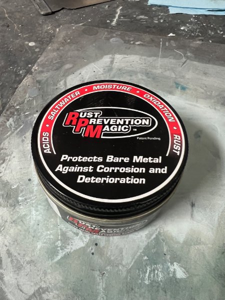

This is the best stuff I have come across.
I use this stuff. You have to warm the part with a heat gun or something and rub it on but the part stays nice and if its not handled, it will stay like that for years.
