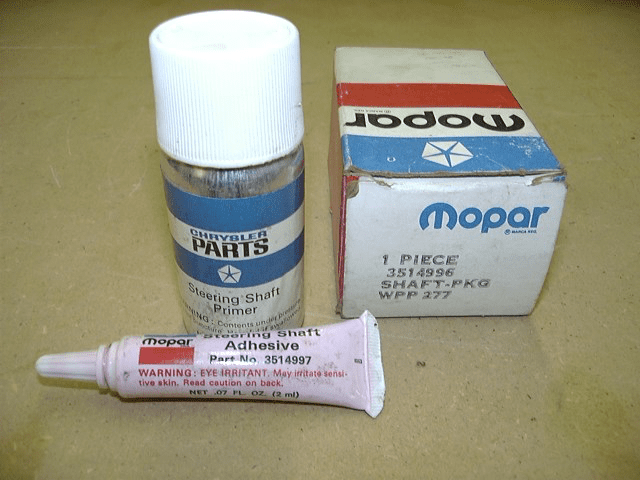

I could be wrong, but I don't think the factory even used actual "pins" per-se. I think the two locations were injected with melted plastic that solidified when cooled. Hell, you could probably do the same thing with some liquid epoxy or something similar in a syringe.
The old plastic or whatever it is likely gets old and brittle with age.
I could be wrong, but I don't think the factory even used actual "pins" per-se. I think they two locations were injected with melted plastic that solidified when cooled. Hell, you could probably do the same thing with some liquid epoxy or something similar in a syringe.
Im not sure, I just remembered the rebuild kit Mopar use to offer. I thought it was a rivet or pin.
