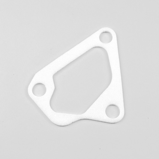

I may be able to help, if you need the lower steering column bearing.
Made this for a guy a while back, and it seemed to work for him, only issue was the pocket for the bearing. He said it was 2", and it ended up being 52mm which is 2.047", so he had some sanding to do... easy fix on my end tho.
made out of fiber reinforced nylon, on a high temp custom printer.
