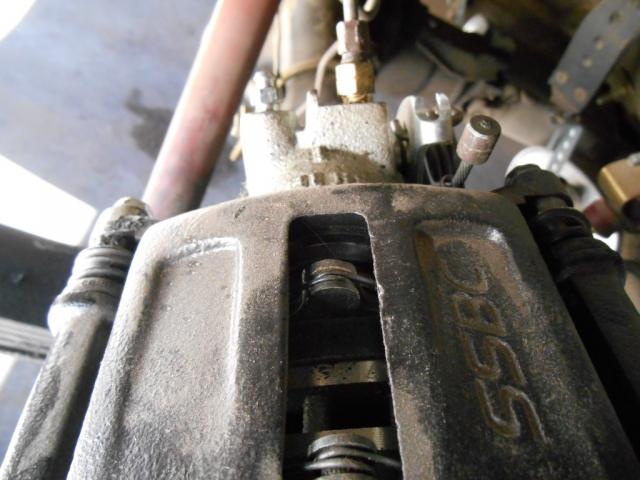

No it's 4 disc. I wasn't quite sure what you meant by bleeders up on the rear and I think I need to swap the calipers side to side. the bleeder is actually lower and behind the line that comes in.

Yes. You'll never get the air out the way they are installed now.
I cannot tell from that photo which end is up, but if the bleeders are lower than the line inlets, you need to swap 'em
thanks for the help. I guess I have more work to do. I'll start with the swap and go from there. Thanks again. I will follow up with the progress if any:)

You guys are AWSOME:wav: Especially 67Dart273!!! I swapped the calipers and just gravity bled about 3 ounces of fluid off each bleeder and I got friggen awesome brakes!! I can't believe it was something that simple:banghead: Many thanks to all that replied and got me going in the right direction.
