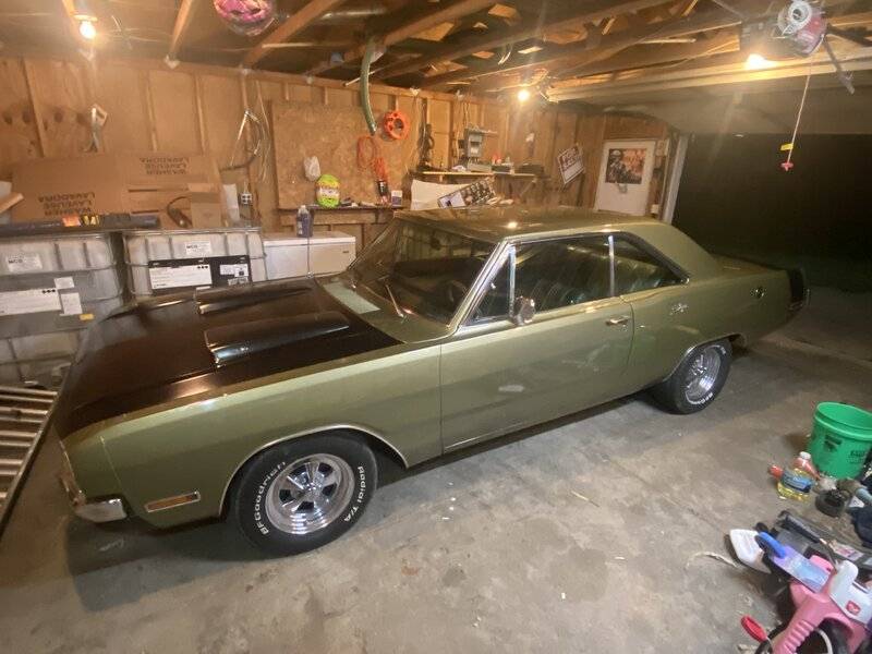

Will Cragar SS 15x8 fit my stock dart? And if so what’s the biggest rubber I can run without clearance issues??
I have 15x7 with 4.5" backspace with 255/60-15 They are tight on the quarter panel side and mine probably don't rub because of the rake. 70 series would be taller.
I run an 8-in cragar SS outback but it's very tight. I have about a half an inch from the leaf spring and the car sits up more than some people would like. I would actually like it down a little more in the back but I wanted the extra traction provided by The wider tire. 275/50/15 Nitto Drag I run a 2-in over Arch 6 spring leaf pack . It took a little tweaking it's not really a by the rim and tire slapping on there deal, but it's not that difficult.
I run 15x7 with a 4 1/4 backspace, 255/60/15, offset spring hangers, with the wheel lips cut to the pinch welds. I could probably run 15x8 with a larger offset. 1970 Dart.
