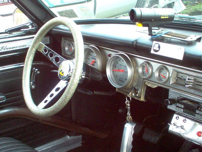

stock dash,with after market gauges,,is popular now,,,i did this back in 1996...may of been one of the first,,all the others were doing the sheet metal dash,,i hated that look so i made after market gauges fit the stock dash,,

I'd love to do that! I'm thinking too... since I no longer need the stock gauges maybe I can somehow get a tach to fit in the stock dash in place of the gauges. I have a 73 though, so it's a bit different than yours.

man fish! I love your tach and where you put your shift light! Dash looks great 8)
thanks,,the shift lite is mounted on a bracket that slides under the dash pad,,so i didnt have to drill holes,,and use to have a fuzz buster there also,,lol
as for the other dash,,is it the rally dash ? round gauges?? if they are 5 inches,,or less,, there are companies that make round clusters,,with more then one gauge in the same round pod,,get a street rodding magazine,,and you will see what im talking about,, you could have on round pod with 4 gauges in one hole and a tach in the other,,,
Im with zach,fst fish,awesome dash there!
Awesome car too !
I like the dash as well, very cool. I never went that direction in dash, but had alot of aftermarket gauges around steering wheel and below dash. A few years ago I purchased a new factory tach and vacumn plated my original cluster and got all the factory gauges working, and I really like the factory look (more nostalgic), but I also don't race it as much any more, So having a new oil pressure gauge is not as crucial as it use to be. It's all good, you just got to do what you like.

thanks all,,when i got to the dash part i was in a hurry my house had sold and i was moving from ill back to pa,,,so thats why the dash bezel didnt get replated,,i have another bezel modified ready to go,,but im going to try the re chrome my self,,if it doesnt turn out nice it will also go to VAE,,, from what ive seen his work is really nice,,and a lot less then the others charge,,then when i do it,,or for any one else i suggest you make a harness with a master plug going to all the gauges,, so removal is simple if you ever have to,,,

a 65 valiant has only 2 round holes,,,my gauges are auto meter,,ultralits,, you can buy gauges that have like 4 different gauges in one round pod,,around 4 or 5 inche holes wil be required,,,lots of dirrerent gauge companies,,im not sure if auto meter makes gauge pods or not,,pick up a street rodding magazine or do a search,,but a complete set of gauges these days is between 4 - 500 bucks

fstfish66~ looks good! Looks like you had change left over too... stuck in your ashtray? Ha!

never any money left over,,,lol
ide scratch the ammeter,,no need,,go with a volt meter in the dash bezel,,and time and EGT or compass, vacuum,, in the radio delete
where are you putting the radio ?? and are you rewiring the complete car ? if not delete the ameter,,tie those wires together,,pic of the gauges yet?
