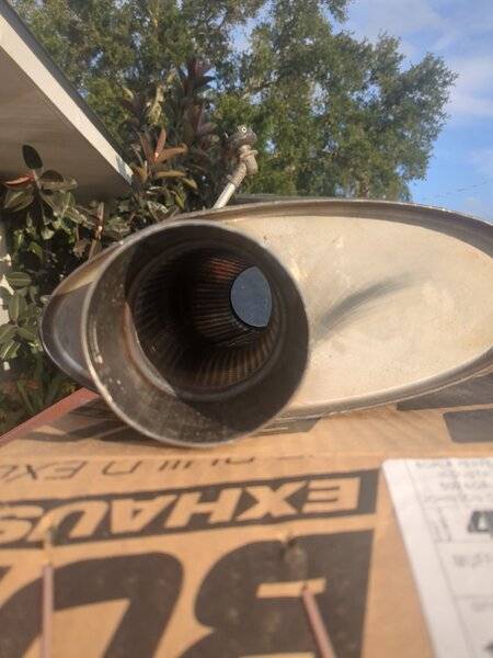

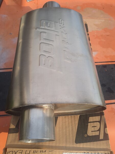

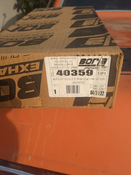

These Borla are going on my 70 Dart
3 inch , 2 1/2 available, got em last yr $80 each
Look up Borla XS series reviews
