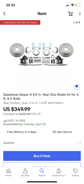

Has anyone fit the (summit, speedway, pirate jack; they all look the same) E-brake compatible rear disc brake kit to their 8 3/4” A body rear end, and been able to clear 14” rally wheels (4.5” BBP)? They say 15” wheels but I’ve got 14x7” 4.5” Rallye wheels that I heard can fit some disc kits. Thanks!!

Go to your local salvage yard and take the rear dice brakes off of a JEEP Liberty 02 to 07 or a Grand Cherokee 96 to 98. save lots of money. only one mod to the caliper brackets and its a 100% bolt on. Some other little tweaks to the E-brake cable. See my story in Mopar Action. AUG 2018 Epic rear Disc-Brake swap. OCT 2018.
