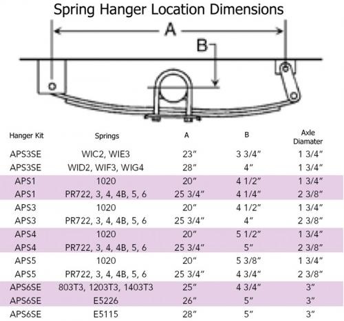

check this thread:
http://www.forabodiesonly.com/mopar/showthread.php?t=3558
that page has this picture:
attachment.php
