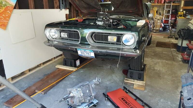

Supporting engine with trans removed
Floor jack with a 2x6 under the oil pan with just a slight bit of tension to keep the engine stable. I just removed my 727 and that is what I did.
