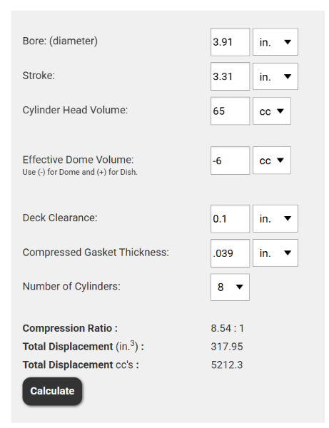

So are my calculations wrong at the ~8.5:1 ratio with those fel-pro gaskets? I'm okay with that number for the money I have in this, but at 8.25:1 or even less...that's not great considering the 273 was 9:1 or so.

You used a -ve number for piston "dome" volume? You're using domed pistons?
Also 0.10 deck clearance?

The calculations I just made with compression show a compression ratio of 8.5:1, which isn't bad. The stock gaskets seem to have been .069, so I imagine that could make a difference? I could be doing something very wrong though, as I've never messed with compression ratios.

The .069 number would be the deck clearance, which is how far below the decks your pistons are.
.069 is about 13.57cc, which has to be ADDED to the head volume.
OPEN chamber 318 heads usually come in around 70cc.
IDK; about heart-chambers, or Magnums, nor about the early 273/318 closed chamber heads, which seem to vary between 57 to 63cc, IIRC.
039 FelPros, which are actually 4.18inches round-bores, to fit the 4"Plus bores, come in at 8.8cc, and don't forget the Crevice volume of about 1cc.
This totals 70 +13.37 +8.8 +1=93.17, before you add for piston dish. This makes your SCR to be 7.99, BEFORE adding the dish, if any.

I am struggling to understand the compression situation. All the information I can find on these pistons are flat top, at most a 4cc dish. If I was to use a steel shim at .028, assuming a deck height of .069, 70cc for heads, and 4cc for the pistons, I am getting 8:1. Taking into consideration altitude as mentioned it will be even less.
With flat pistons, and .020 shims (as claimed with Fel-Pro 375-SFL8553SP) I am getting 8.44:1 before taking altitude into consideration.
