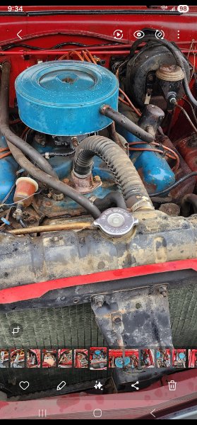

When switching from the LA 273 over to the 408 magnum, is it recommended to use the old LA style waterpump and radiator (this is prefered, as I like the old school look) and would like to keep the current radiator if possible, however I do want to run aftermarket AC.
Reuse old radiator?
Use 1965 barracuda style water pump? (new of course)
Thank you

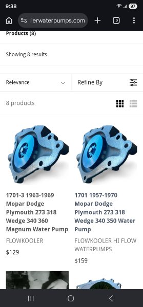

I recommend a FlowKooler water pump. They make one with driver's side outlet. It made all the difference in cooling my Magnum.
Sounds good, I think the 1701 has the 2 outlets vs 3 with the 1701-3. Ill but running afterrket ac so I guess go with the 1701. ?

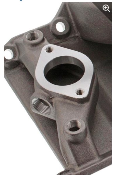

It seems my intake manifold has a good set where I can do.the same bypass as currently set up?

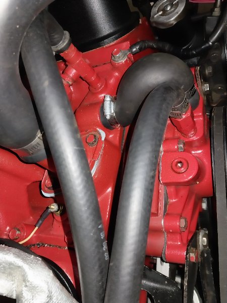

I just looked at mine. Seems I bought the 3. Didn't notice options when I ordered. I plugged the unused port. Finding the bypass hose was the most challenging part.
