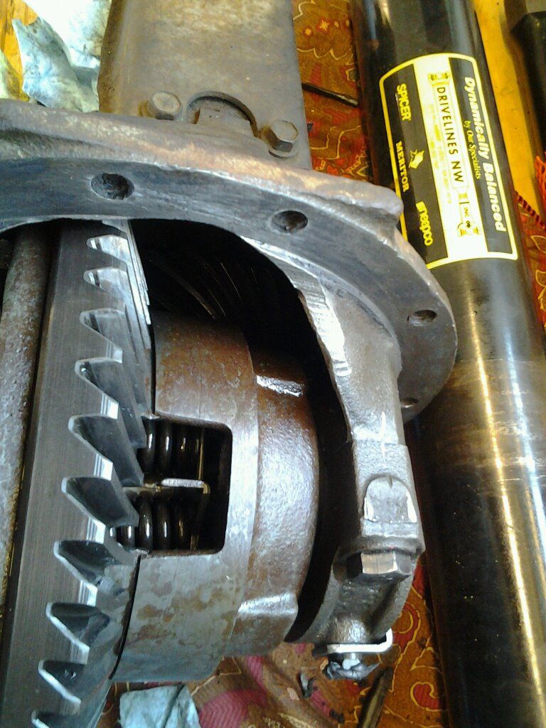

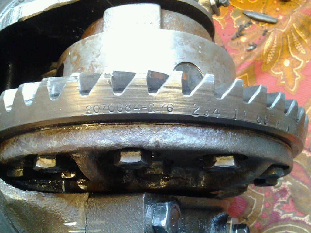

So i took the Duster 8 3/4 out, it looks like its in pretty good shape, no play in anything. Its a 2:76 Sure Grip.
Before is swap it to the Bee, i was thinking if it would really be worth swapping it if the Bee has a 2:93, or 3:23. Sure i would loaf along on the freeway, but wouldnt it be gutless of the line? The car is not raced.
Maybe you racers can help figure out the ratio, i may just do the seals and bearing depending on what you guys think. The tires on the car are 28x10x15's
I marked the tire at the bead, and marked the drive shaft yoke, and rolled the car on the ground. the tire went around once, and the drive shaft went around 4 times. Anyone know what that would make the rear end?

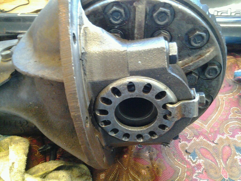

Gotta ask, what's your center section 741,742,489?
the Duster has the 742, the Bee has a 741, guess i will find out tomorrow what ratio it is
if tire went around once to 4 turns of drive shaft it would have to be 3.91 or 4.11s
(I forget Mopar gearing ratios) I have 3.23s so my driveshaft goes around a little more
than 3 turns for 1 tire.(I put it up on jacks once just to check)
