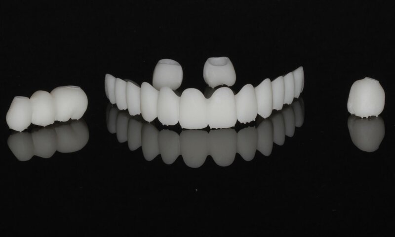

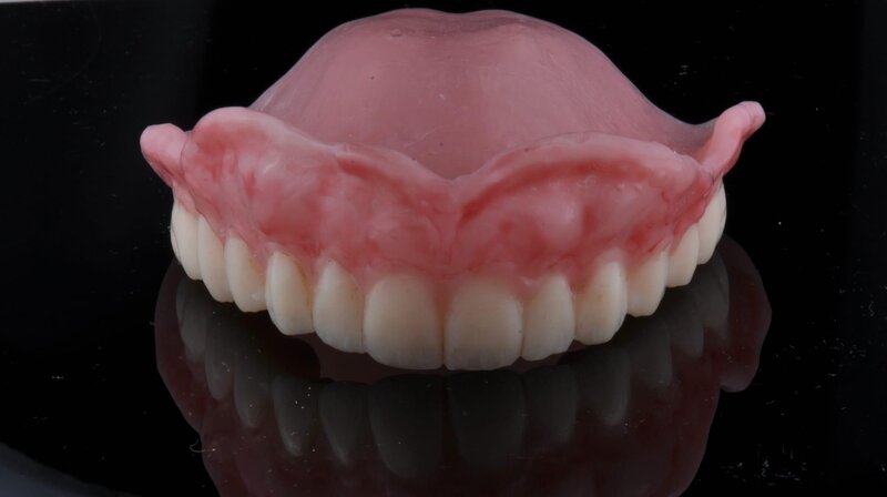

I’m not going to a convention but I am going for a dental continuing education course. It’s a 3D printing course, it is so I can do more procedures with my 3D printer. Right now I use my printer for surgical guides, models and basic stuff. Soon I want to be 3D printing dentures, partial dentures and implant retained dentures.
Being able to do this will allow me to be able to offer more services without pricing myself out of the range of most people.

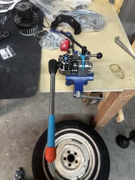

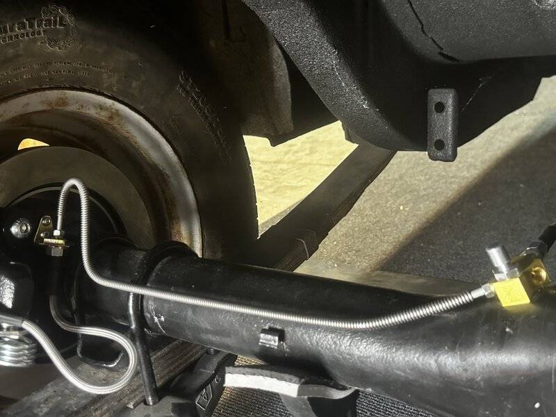

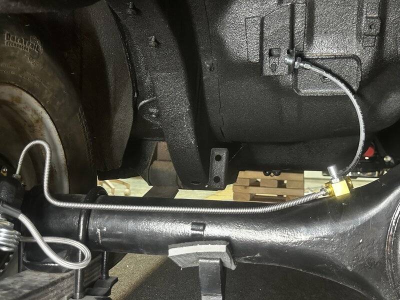

Brake lines pissed me off. Pre-bent lines were for rear drum brakes, lame.
Got the tools and ruined most of the metal lines, should have gotten a fancy line bender, but I just have the cheap one. The wife’s mixing bowl helps make the bend on the housing pretty well though.
I have a good drivers side and usable passenger side, enough line left over to remake the passenger side, since I forgot the protection sleeve on it anyways.
I ruined most of the line trying to get it perfectly through the oem metal tabs… well I’m probably not going to use the metal tabs.

Well the pre-bent kit said for disc brakes, but apparently that’s only the fronts.
It’s ok, I can do it… I’m just a grumpy old man.
Do you have the old lines? Take it and a 2x12. Trace the line on the 2x12. Cut along the line and then bend the new line to fit the template. You might have to get creative at the brake end.

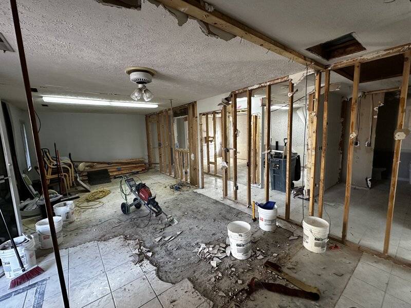

Been a couple weeks. I’ve been slammed. Remodel at the office started so I had to get half the office cleared out and consolidate the other half. I did take a bunch of cabinets from the office and I’m going to use them as shop cabinets, can’t ever have enough storage.

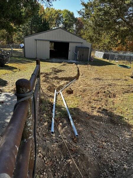

Planned on working on the dart this weekend since we took a 4 day weekend but my wife needed me to do other things… mainly rerun power lines to the barn so her chickens can have light and heat this winter… lol. I’m almost done.

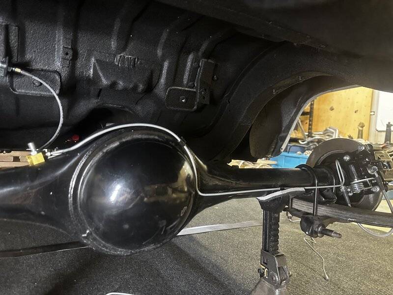

I did finish the rear brake lines though. My plan is to start pulling the engine and transmission next.
