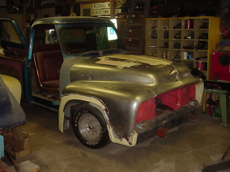

The Chevy guys are gonna love it ! My dad has a 55 ford pickup with a 440 He loves it even though most people frown at it
