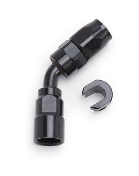

Thanks again. You gave me a couple of new ideas. I'm using the PTFE hose and Russell fittings from Tanks. The fittings are all 180* so when assembled the filter takes up about 3/4' of linear real estate. Didn't think about it until seeing your pics, I need to swap in a couple 90* fittings and a 45*.
