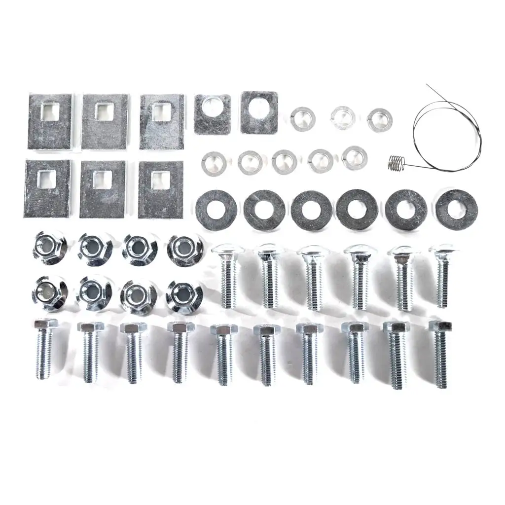

Still have to wire it. Bought it on amazon for a jeep Cherokee.

I bet some of us would appreciate some photos of how this looks UNDERNEATH. I can't really tell....is that a 2" receiver?
2" receiver.
Had to notch one of the holes on both sides of the frame rales to fit the square plates.
Drilled 3 holes on either side.

I didn't use all the mounting holes and 1/2 the hardware that came with it. The boat isn't very big though. The other thing that has me worried is the amount of crap inside the frame rail. plan on driving it around and hosing it out before taking it on any trips.

it would honestly take 5 minutes with the impact to unbolt it. snug the nuts back up when your not using it. only problem is you'd run the risk of pushing the bolts back up into the frame every time. If you could find these it might help the situation.
