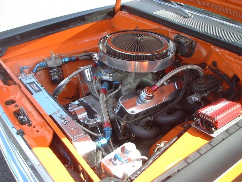

i removed the stock booster and master cylinder and but a newer model mopar master cylinder on a 73 Duster....
brakes work just fine.
