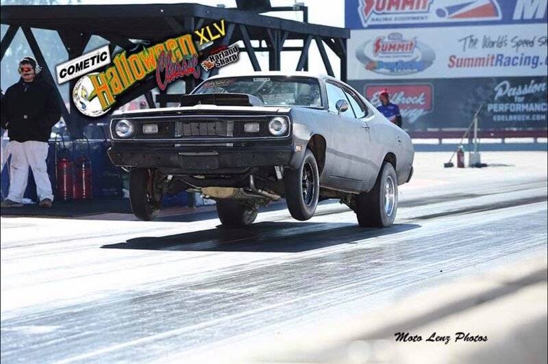

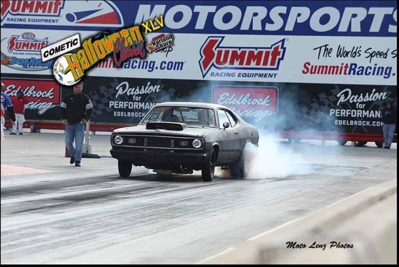

Rebuilt three times and pulled to be rebuilt for the fourth time Matt needed an engine so we put it back in service. It went 6.41 on this pass but I think he ended up going 6.38 during the Halloween Classic this year. I know he went 10.11 during the Father’s Day Mopar race at Keystone the next year. This was the old block I wore out two sets of stones honing it on its third rebuild. 3200 pounds with a 727 and 4.10 gears in his 8 3/4 rearend. I can’t wait to see him out in this car again.

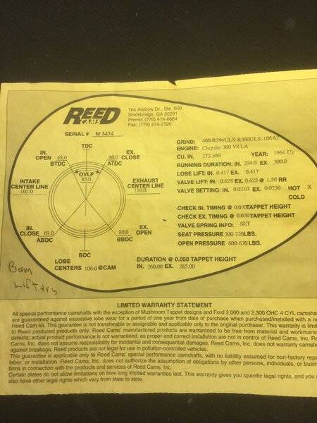

App .630 roller cam (Reed cam I’ll try to post cam card)
