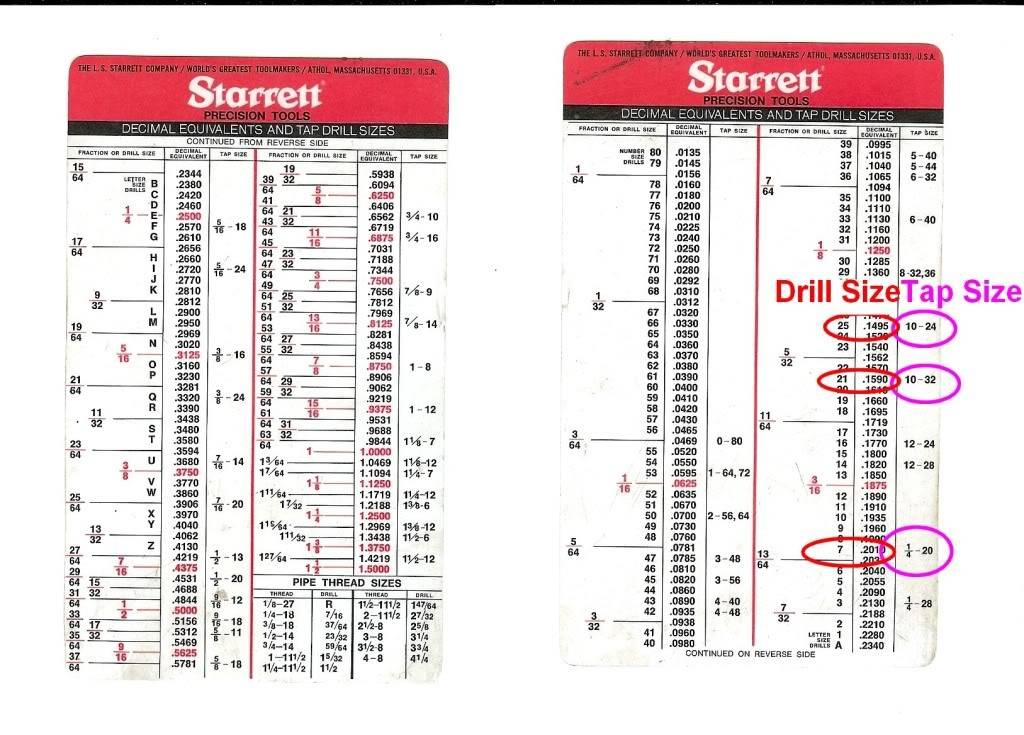

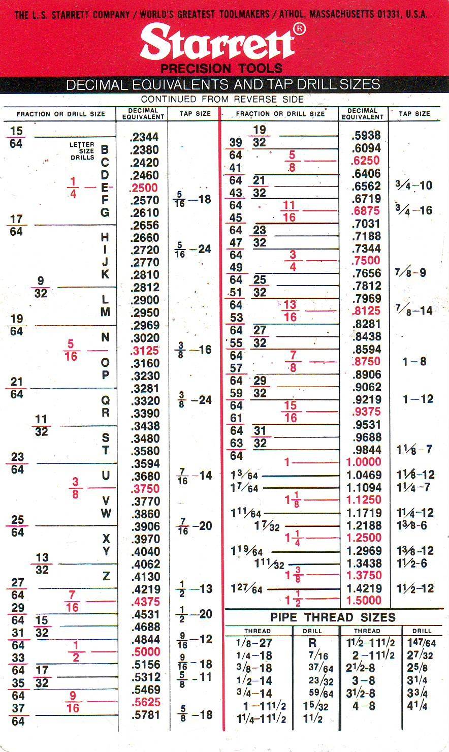

Ok then, what size are you trying to go for...
There are charts to tell what size hole to drill to tap for each specific thread size. You need to look up what size thread that you are going to use and then use the chart...
Thanks............I'll do that.
Here's the chart I was referring to...
