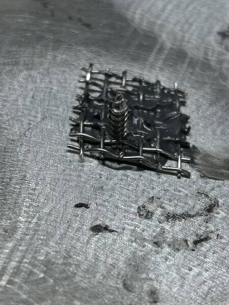

A-body armrest - stripped threads in door’s sheet metal
That should work ok.
Use this.
Permatex® Steel Weld 4 Minute Metal Epoxy

Why not just cut out 2 rectangles the correct size and location for the clips you bought, (like in the photo of my post with the 67 dart door)
Simple, no welding, permanent, repairable by replacing the clips in the future.
Sounds like a good solution but I’m not sure of the difficulty of getting the location correct. Apparently the clips I bought before removing the door panel were intended for the rectangular hole that you show.
I just happen to have a 67 dart with the doors stripped, I would be happy to get you the dimensions or even a part template
Thank you for the offer but, before you invest the effort, I’ll try one or two approaches that require less metal cutting and accuracy. I’ve experimented with JB cold weld epoxy combined with a small piece of steel mesh and I was unable to strip the thread using a screwdriver. I took delivery today on a box of U-nuts which I’d consider a backup that requires less cutting accuracy. I might even consider a combo of the U-nut plus the JB cold weld.
That's what I would do my 70 duster has one original door & one 71. So 70 has clips one does not. At present I don't have a problem but someday I might. There are other penny pinching differences between years. The duster nameplate on the painted part of the door in 70 they were held on with counter sink oval top sheet metal screws, 71 had round holes with sheet metal spring clips that grab plastic posts on emblem.
