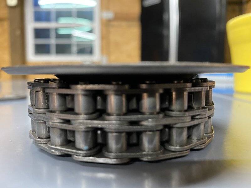

I put the Comp 2103 double roller on and it is much tighter then the other set I put on. So just double checking, you guys wouldn't run a tensioner with the type of chain the Comp 2103 is? I may still be interested in a tensioner if it's not gonna get eaten by the double roller.

Will the double roller eat through the tensioner though?
No. It may wear thin track lines into the shoe, but that’s about it. And it’s normal. Some guys make things that are a speck of dust into a huge mountain for no reason.
For like the fifth time now. No, not if you use the correct style chain.
