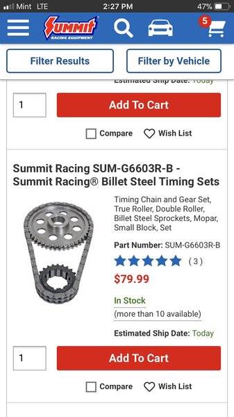

Summit one says it only fits up to a 91 360. My engine is from a 2001 truck.

Have one you recommend that has all the stuff you mentioned under $100? The Comp seems to have everything but the 9 keyways. The summit one mentioned above would be perfect but for some reason says it won't work on a 2001 magnum engine. The earliest it goes is 1991.
The type you want has a few features. First, I recommend billet, because the billet set will have less stretch. They all stretch some at break in, but the billet sets stretch much less. Secondly, a true roller set. That's where the connections between the links really roll independently. Another footnote here. You need to look for rollers that are not split rollers. Those are normally found on the crappy sets parts stores get and all the Chevy guys think adds 100 horse power. You can look at the rollers and see where they have a split. They are just formed right over the pins in the chain. You want full, one piece rollers that are typical on higher end sets. Lastly, I like the sets with nine keyways on the crank gear. Some think that's overkill, but it gives a WIDE selection of where to install the camshaft for best timing, rather than being limited to either one or three keyways.
Have one you recommend that has all the stuff you mentioned under $100? The Comp seems to have everything but the 9 keyways. The summit one mentioned above would be perfect but for some reason says it won't work on a 2001 magnum engine. The earliest it goes is 1991. I like the summit one but I'm not sure why it says its not compatible with my engine
I like JP/Rollmaster. Summit won't have those. There are a few US ebay sellers that have them. They are a high end product from down under.

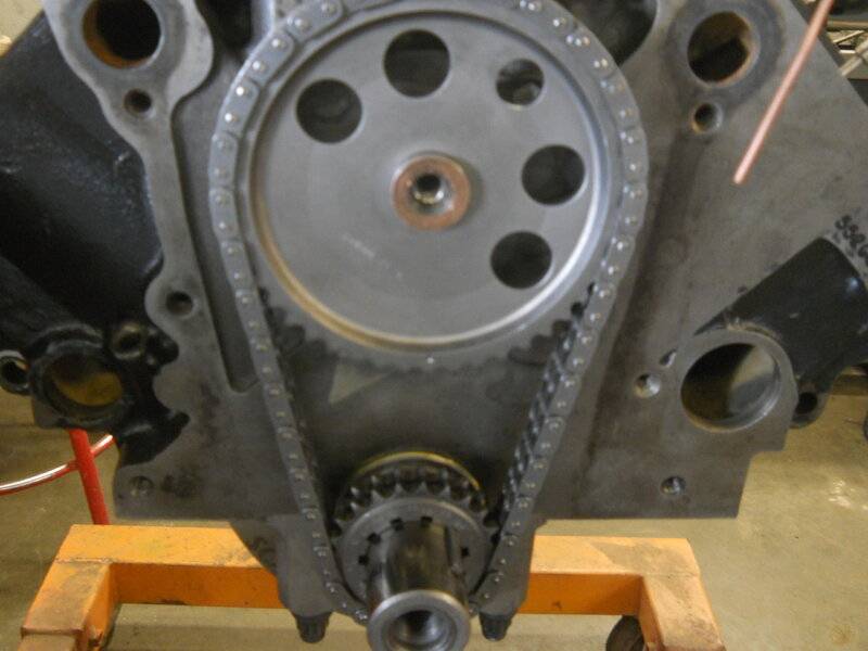

The pics in post #21 are very revealing. The gunked on, dried residue on the chain suggests that it was getting very little to no oil. If the chain/spkt had gotten a constant oil supply, there would be no chance of sediment build up because of the constant oil supply washing over the chain.
A very good reason to improve oiling in that area.
