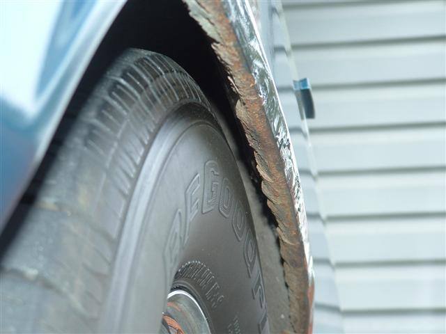

I just picked up a set of used Cragar SS rims and Tires for a deal ($360) and I want to put them on my 71 Scamp, I just have some fitment issues. The wheels are; (2) 15x7-4 1/4" bs with 245/60-15 tires and (2 ) 15x8-4 ½”bs with 255/60-15 tires. I know the 245's definitely WON’T fit on the front. The 7" 245s fit great on the rear with no fitment issues however I would have to sell the 8" 255s and get a pair of smaller ones for the front. I put the 8" 255s on and they rub against my fender lip when going around corners but man do they look good. Has anybody ran this size on the rear? Anybody cut the lip back or bent it under? If so what kind of results. If I can achieve this I’ll just throw a set of 205/65s or 215/60s on the 7" rims for the front and be happy. I hate to invest in another set of rims for the front when I already have these. I have one of each on the rear currently for test fitting...... see pics .... 15x7 245/60 on the passenger side and the 15x8 255/60 on the drivers side. Any body have any ideas?
If the 255s only rub when going around corners then I'd try "rolling" the lip on the rear fenders. If you're not familiar with the term, You take something round like a pipe, dowell, baseball bat, etc. & wedge it between the tire & inner fender lip & roll it along the inside of the lip. It bends the lip up & gives more clearance.

So that's what "rolling the Lip" is. I was thinking of cutting the lip half off at the top and "blend" the cut down the sides. I could use my Dremel Toll to do the job. The 'lip' is about an inch wide were its rubbing, I was thinking of removing the chrome trim, cutting the body lip then replace the trim and roll it around the cut area. Anyone done anything like that??????

Because my Signet had the low rear wheel wells, and the rims are a deep dish style the tires (P245 60 14) would only rub going over bumps or if someone was sitting in the rear. I ended up lightly rolling and pounding with a rubber mallet on the inner well. (worked good). My total clearance is only about .25 inch, but safe...as long as I never get a rear blow-out :notworth:

I have 15 x7`s on my 68 Barracuda with 4.5 backspacing. I`m using a 255/60- 15 tire with at least 1.25 inches to spare before I come close to the lip. Evidently your wheelwells are not as deep as the Barracudas, but you should be able to get a 255/60 in there without a lot of trouble, if you get the backspacing right.
You can't fit a 255 on the back? I have 235/60R15s on the back and they look puny. I can EASILY fit a 255/60 on the back. I'm thinking of trying for a 275/60 IF the diameter isn't too much. I would REALLY like a 295/50, but that would definately require rolling the lip on my car.
