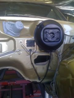

Metal work
In these shots I epoxy prime the blasted metal, delete the blower motor and smooth the battery area and body work the areas. We also begin to look at the color for the car and it's formula.

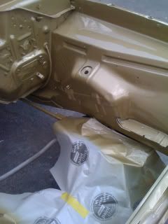

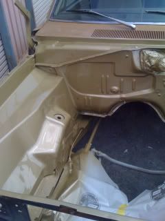

Paint
Color code JJ1 Ember Gold Metallic.

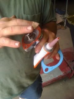

Disc Brake Upgrade
So the '73 Dart Sport gave up the power Disc brakes and the large bolt pattern for our Plymouth project and so I took a few shots to show them being rebuilt.
[ame="http://www.youtube.com/watch?v=2tlJy1ji-pE&feature=relmfu"]‪MUSCLE CARS & HOT RODS Episode 174 1973 A-Body Disc Brake Upgrade in our 1968 Plymouth Barracuda‬‏ - YouTube[/ame]

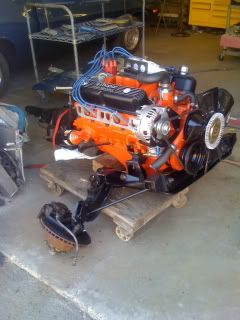

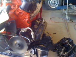

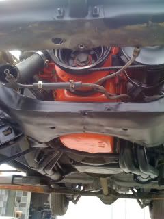

Installing the Motor and Trans. on the K-Frame.
Building the K-frame by putting the lower control arm assemblies and steering gear on then of coarse setting the 318 and 904 in place.
[ame="http://www.youtube.com/watch?v=D38KRqQEhLk&feature=relmfu"]‪MUSCLE CARS & HOT RODS Episode 175 Installing the Motor in the K-Frame of our 1968 Barracuda‬‏ - YouTube[/ame]

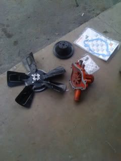

Getting ready for First Start
Various tidying and chores in preparation for the first fire including battery relocation, wiring issues, lowering rear suspension, adding -06 braided fuel line and a bad water pump.
