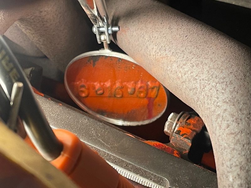

While I'm waiting for parts thought I'd do a little detective work on the engine to see what it is. Looks like it's the original motor. I'm guessing it's been rebuilt. It's got a 4bbl, Holly and headers on it right now.
Numbers I could find on the block. So I know casting date and it was built at Mound Road and the original motor was recommended for regular gas.
PM318R
2536030.318
6.16.67

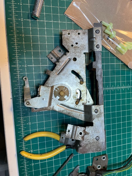

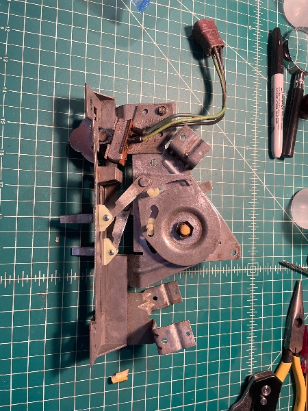

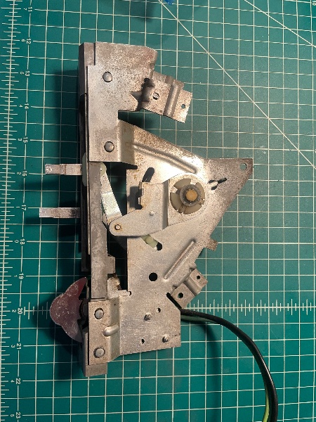

Discovered why the heater was disconnected. This car is heater control door and assembly delete.
There are no clips because screws better? The hanger holding the vent plenum up is missing and the bracket broken AND drilled out from the bottom (HULK MAD HULK SMASH!!!)
*Sigh...Looks like I'm rebuilding a heater box over the winter.
Anyone have a decent heater box that can be rebuilt out there? I can possibly rebuild this one but there's a lot wrong with it.
The heater controls cleaned up nicely though.

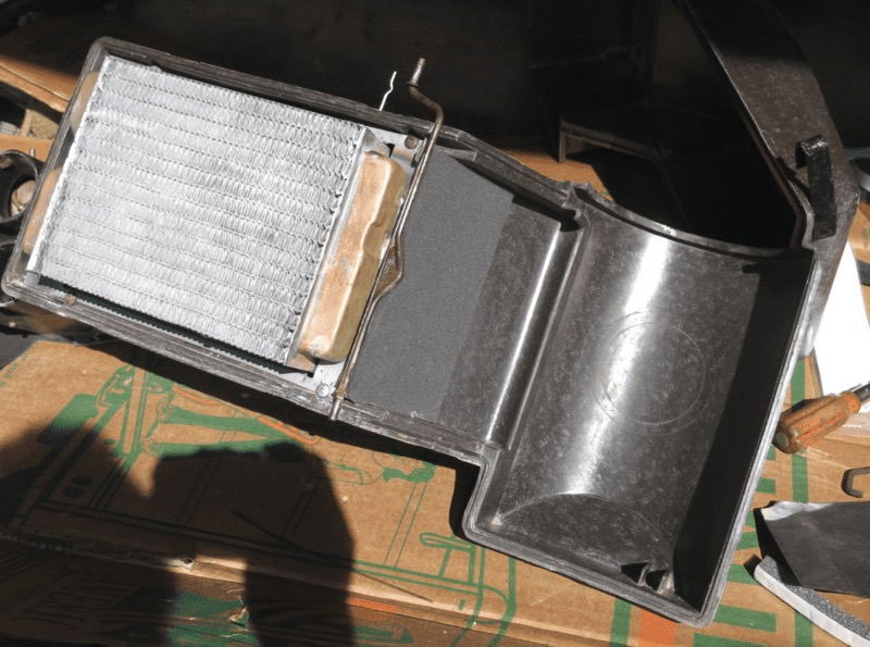

This is all that I really need to get the heater box working. Everything else I can probably repair.
I wonder if I can fabricate a heater control door. Found a pic. Looks pretty simple. Is the rod and door just hanging out in there and held in by the other half of the box?
Maybe someone has an old box with a usable one?

@RAT ROD AL may have heater parts. There was a hole in pass side air box too where the hook mounted. I mixed up JB Weld and patched the hole, as well as put a small piece of metal in for reinforcement.
Fyi, relieve some of the tension off the metal "snaps" that hold the 2 bakelite halves together. WAAYYYY too tight and will break brittle bakelite with ease.

Well right now it has no "snaps". A previous owner apparently thought the snaps were inferior so he screwed the halves together. :BangHead:
Does appear that the doors rod is captured between case halves. I have known some that would knock the clips off and swap in a heater core and think, "Kanocking these back on will be a pain. Especially the ones at top. I'll just shoot some screws in it."

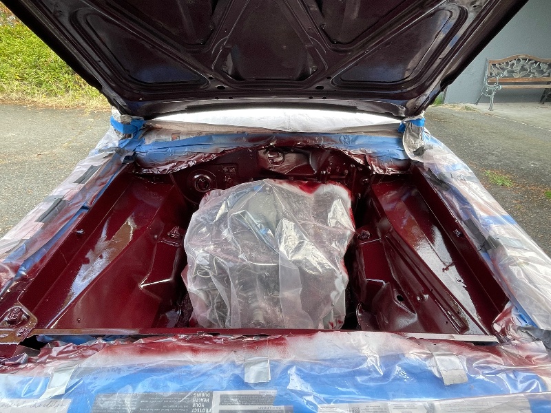

Whoever did the burgundy repaint did not prep the upper firewall correctly (no primer and no sanding) and when I removed the tape it removed some of paint with it revealing the original beige so I ended up doing sanding and primer on that and the fender area.
I just figured that was the universe telling me to not take the easy way and I should have done the whole bay to begin with.
I used 2K rattle cans with a single stage paint in factory RR1 Burgundy poly.
The exterior of the car isn't a factory color. It is darker and more blue and more metallic.
The plan is to eventually repaint the whole car RR1 Burgundy.
