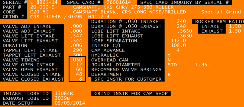

Amazing close to my CompCams piece which is the 112 LSA version of their XR292HR based on 110 LSA!This is what Howard's recommend for my TFS190 Headed 390 Magnum build.
Not quite the match to what you requested above, but...Other test I would like to see, Change the durations and LSA to maintain the same overlap.
228/234 on 106 lsa vs. 232/236 on 108 lsa vs. 236/242 on 110lsa vs. 240/246 on 112 lsa
Yup, #1 was the previous combo (but 360 motor) and #2 is the current combo (but 408 motor).So, #1 is your previous setup and #2 is your current. I am surprised that they recommend a cam as big as your Compcam, considering how much vacuum it gives you. They originally said the same duration but on a 110lsa. I reminded him of what I filled out on the cam info. Form, that I have Power steering, power brakes,A/C and am looking at a 3,000 stall converter. That's when he said to put it on a 112 lsa.
