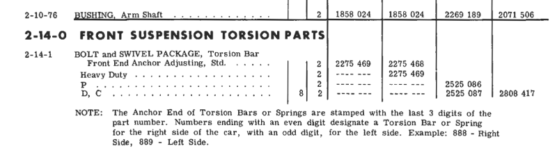

I’m going to install my torsion bars & don’t know which is left & right? #’s are 466/888 & 466/889 thanks for the help
they should be marked L and R
but i'm pretty sure odd number goes to the left or driver's side.
does not matter which direction they go in, front to rear, just that they are in the correction position left or right
when you look up the part number in the parts book the page.
odd = left
even = right
Yes their marked L/R thanks I wasn’t paying attention
