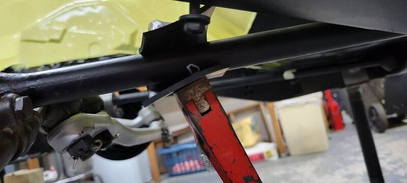

I'm working on a car that has no engine installed, so that gives me a little bit of wiggle room. Plus, the bars had not been installed for a long time, so they were not full of grunge. Here is how I knocked the torsion bar loose.
I had a piece of 1/4" neoprene that I wrapped around the bar. I loosely put a pipe wrench on the neoprene, cocked the wrench a little toward the back of the car and whacked the wrench one time. Presto!
There’s no need to grab the bar with anything. Disconnect the LCA from the spindle and shock, remove the strut rod nut and the LCA pivot nut. Use a dead blow hammer or rubber mallet to tap the LCA back and presto! Torsion bar comes out.
If you think that sounds like a lot of work, well, pretty much everything that has to be disconnected to use the LCA to push the bar back has to be disconnected or loose to install the torsion bar again. And using the LCA there’s no chance your tool or grips or clamp will slip and damage the bar.

And, using a pipe wrench on a torsion bar you plan to re-install is a really terrible idea. I don't care about the neoprene you used, it's really easy to screw up and put a gouge in the bar using a pipe wrench. And if you nick the bar with a pipe wrench, it's garbage. There are plenty of people that have had torsion bars literally explode when a crack forms off of a gouge in the bar.
