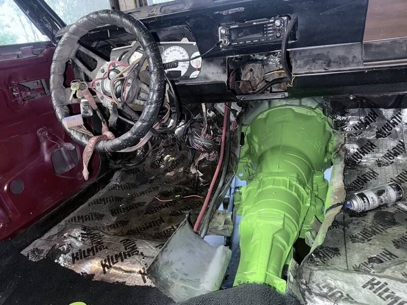

I'm doing something similar to my Duster pertaining to the removable tabs tunnel do you have pics?
