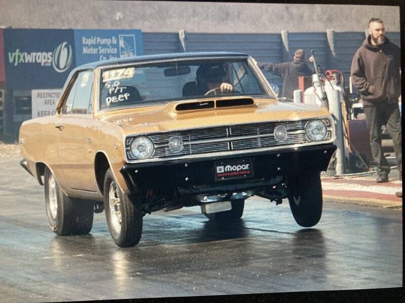

What moparstud said : I have a CSI shield on the small block / 904 in my 68 Dart and I also had to make access holes in the firewall to access the bell housing bolts , my car is high ten second capable but is slowed down to run 11.50s I technically don't need the shield for that E.T but leave it in for safety .
