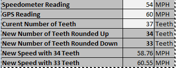

based on your info 6 MPH slow speedo ( Ie your GPS speed is 60 and your speedo shows 54)

this is all based on the info you provided, but looks like you would be safe with a 33 or 32 tooth I would love to get another reading at speedo 60 and tell me what the GPS says (to validate the results) for the record, i haven't yet, but this calculator is what I will base my speedo gear purchase on when I go from 2.93 to 3.23

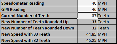

Okay I found a spot to get the GPS to 60 mph and the speedo said 50 mph.
Are you sure the speedo didn't say 52?
It's much easier to get the speedo on a whole number like 60 and read the digital GPS.
By my calculations 50 and 60 is not giving 33 or 32 teeth. 52 and 60 does.
