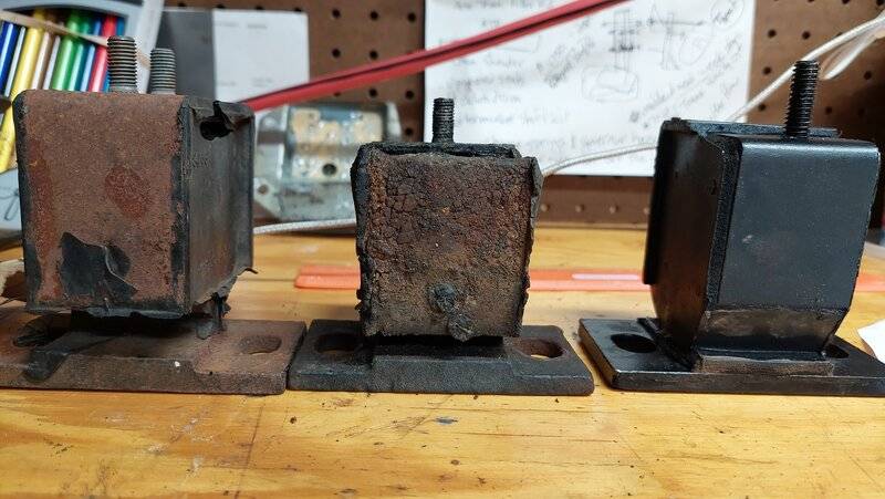

Hard to say what the differences are without having the two side by side. I bought the single stud version shown to fit the '65 V8 A body, but when I compared it to the original 2405872 two stud from my car, the single stud is 1/4" taller, even though it will fit. I just don't know if I want the trans raised a quarter inch.
Original 2-stud in the center. Modern single to the right. NoS 2-stud to the left
I have the same original mount (center) and I also have the right mount w/one stud, just bought it from Oreilly's. I don't recognize the mount on the left, sure doesn't look like NOS to me.

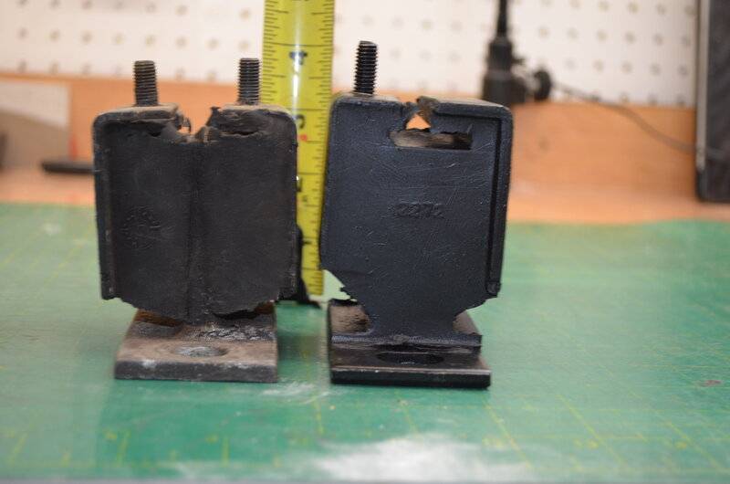

Here is how my original two stud mount compares to the one stud currently available version.
I believe you're correct. I've decided to install it and if the additional height becomes a problem I'll deal with it then.
