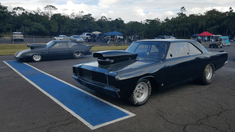

I have this engine in a 1981 Dodge Omni. (Sorry not an A body). It ran a best of 10.29 ET. My Omni is in the far lane. In the near lane is my son’s 1968 Dart. The Dart has a 541 with Indy ported 440-1. It runs 9.3 in the quarter mile.
