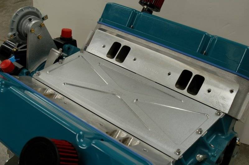

In that pic The head looks pretty tight to the block. Doesn't look like there's enough space to close that gap

Sent the pic to trick flow,they said this is correct spacing,just need to put an 8th inch bead of silicone on each side when installing the intake
I wonder if the ARengineering plate fits tighter than that
here is a pic of my 440 with the trick flow valley pan and 240 heads,is this space to big???
Wonder why they left such a large gap on the sides? I machine my valley plates so they flush with the deck at standard deck height.

I would disagree that that is the plate for an RB. I have one on mine with the 270's and it fits almost flush to the heads. If you want to measure yours corner to corner and let me know what it is I can check that against mine and see. With that big of a gap I would be worried about the RTV blowing out with any kind of pressure in the crankcase.
Not sure I was hoping you would know,they said this is the way they are ,I sent trick flow a pic they say its normal
reply,I was told a low deck would not even bolt up,I measured it,8 7/16 or so in the center from side to side
also 19 inches long on each side
I am not sure what the difference is between yours and mine but you do have the correct one. Those are the same measurements I get for mine. Odd that you have the large gap and I do not.
im going to take the head gasket off the block and set the heads on and check,also make sure the heads are on the dowels all the way,this is the only other thing it can be unless anyone else has and idea???LOL
any way took the head gaskets off and put the heads on without them,heads laid nice and flat against the block and still this gap of about 1/8 of and inch,maybe slightly more,Im stumped if this plate measures the same as yours then why do I have this gap?something different about my heads?I also tried the intake by setting it on and it lined up exactly,AndyF what is the width of your valley plate?
I don't know... looks like it would work fine with the batwing to me.
sending the trick flow back,may just use the old tub intake gasket,less screwing around with all this,so many fitment issues with all this stuff,trying to use newer made parts but not liking all these problems,I've sent back more parts in the last few months because of figment issues
Actually the batwings in the pic are not even lined up,they are resting down on the valley plate,when I raise the batwings and line them up with the intake holes there is still a wide space,something's not right,this plate is not made correctly,not wide enough on a rb with the 240 heads,beware of this
