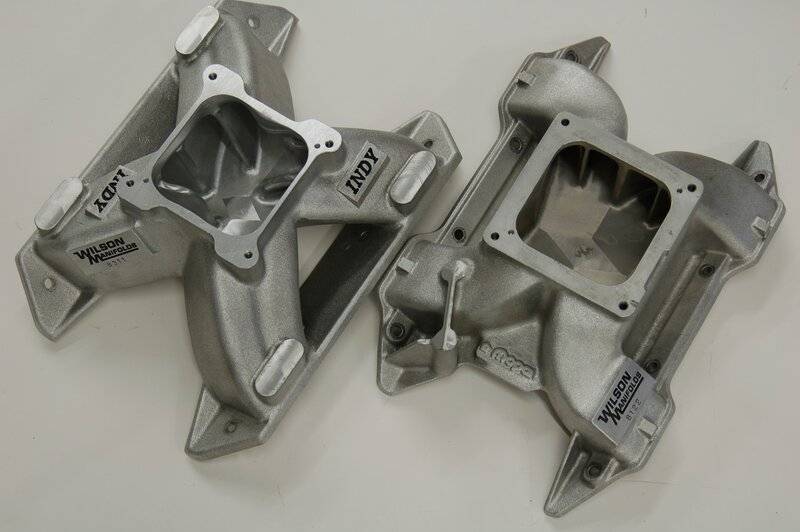

The Indy 400-3 is a MW port intake. The Mopar M1 4500 is a standard port intake. The Trick Flow and Victor intakes are std port and 4150. I dyno tested the 400-3 and a Mopar M1 4500 on my 470 dyno mule. Both intakes were competition ported by Wilson. The Indy made more peak power which wasn't a surprise but we're starting to get a long way from where this thread started.

Andy, I'm looking at the Indy intake in your post #26, was that a 4150 that was opened up to 4500 at the base ? That is a question I was going to ask you. Is there enough meat on the tf to open it up for a dominator ?
