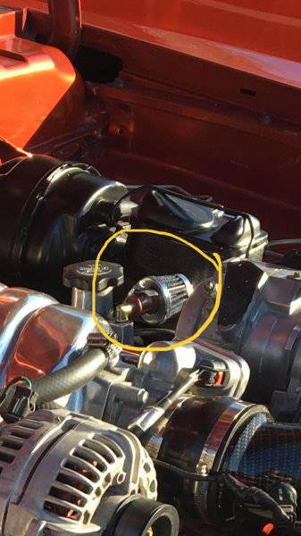

I have the stock intake and I have the port on the back of the intake plugged as well as the small one on the front. I also have the port on the oil cap filler plugged as well. I did have the intake off so I though I might have a leak I sprayed brake clean along the outside edge to look for a leak but the idle stayed the same
You may need a breather filter on the one by the oil cap. It may be that simple.
I tried the breather idea but then the car idles really high like 1200 rpm. see what I mean this car is driving me crazy
ok so after doing the throttle trick and putting the breather back on it seems to run a bit better it is idling a bit high 1100 rpm though and still back fires when you give it throttle could it be cause im running open headers with no exhaust? its not stalling anymore
