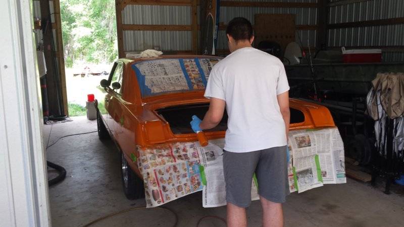

JR's first crack at body work. He wasn't to sure at first, but he learned to hate it.
He actually did a very nice job, even with the crappy tools I provided (sort of on purpose).
Next time, some better tools and maybe a whole paint job!
