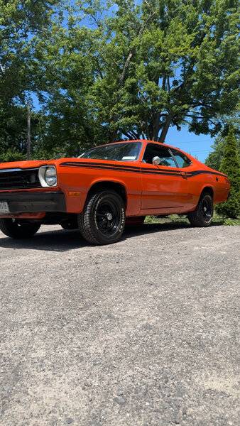

I just picked up this car a couple weeks ago. I got all the vacuum leaks taken care of, cracked vacuum caps, tuned the carburetor, replaced fuel pump. Car wants to stall on deceleration after about a 20 minute ride. I’m thinking of changing fuel, oil and spark plugs. I’m looking for suggestions on replacement spark plugs. 73 duster 340. Thanks in advance.
Beautiful car. Very nice picture from a professional looking angle. I am guessing you are an accomplished photographer.
