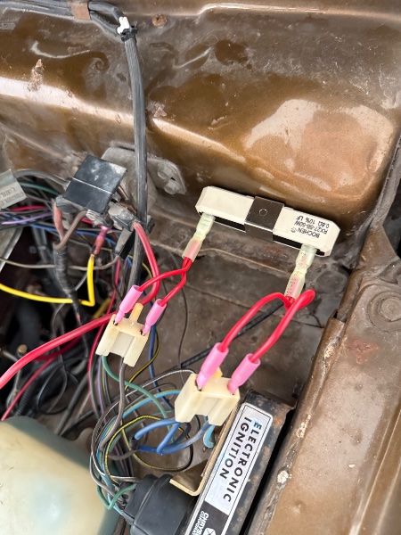

Hello all again,
Finished cutting all the plugs that went to nothing out, now the car will crank but only try and start when the key is released. Will try and trace what I cut out.
Also a thing that’s always been with this car is sometimes when you turn the dash lights on, it will activate the starter. Scouring the service manual I can’t really see those 2 wires being close to each other that might be touching but I will keep digging
Ok figured it out, I had a wire under the dash that came unplugged from a crimp, doh! Car runs again. Now with the MSD ballast installed (with some jumpers) I’m getting 6.5v at the coil while running. I’m not sure if it’s because I just jumped the 4pin plugs to a 2 pin style that killing the last of my voltage so what wires so I have to keep/get rid of to clean it up? See photo

I can’t help notice from the photos that your engine bay wiring looks like a bit of an accident waiting to happen. Hopefully cleaning that up is on the list too?
Yeah I took the photos when I took off all the wire loom, it doesn't normally look like that lol. Gotta make it messy to make it clean. I'll take another photo when I'm done so everyone can judge how I did haha.
