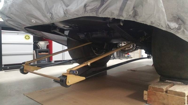

Denny just finished fabricating and installing the wheelie bars for the California Flash Duster. He had been waiting for various components to come back from coating along with the ladder bars which will be installed next. These exactly duplicate the originals down to the last detail as seen in photos from the Peterson archives.

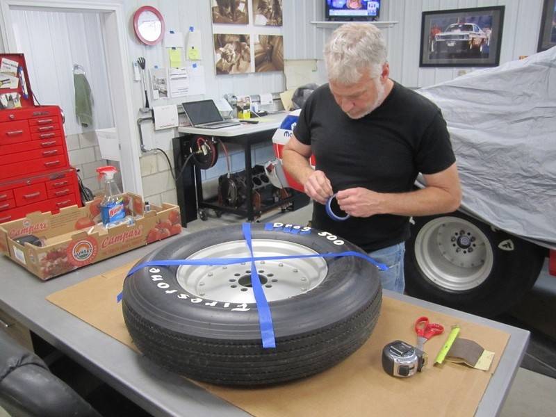

So, how did he do it/ Stencils, free hand / what kind of paint ?
Thot of doing that to my front hankooks , so they would match my rear hoosiers.
Hi Bob,
They are bolt-ons...... well really glue-ons from Tirestickers .com. I think they are die or laser cut. They supply a cleaner and glue that is dyno-mite.
Contact Us | TIRE STICKERS .COM
Bob - If you want to paint letters that are already molded into the tire don't use white (it's too white).
Go to the auto supply and buy a touch-up aerosol of Ford Wimbeldon White. This is more of a "cueball"
white and makes the perfect hue.
