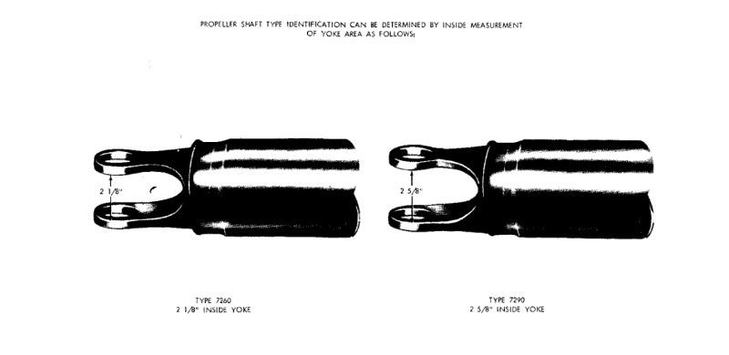

7260 and 7290 are reference numbers, but not part numbers, for the smaller and larger cross and roller universal joints commonly used in most Chrysler passenger cars and light trucks from the late 1950s into the 1990s. A third type, the 1330 series, was used in Chrysler and Imperial vehicles with constant velocity joints and as a single joint in 1966-1967 GTX and R/T. The 1350 and 1410 series were used in some larger truck applications.
- The 7260 universal joints have a 2.125" yoke inner dimension with a 1.078" cap diameter.
- The 7290 universal joint has a 2.625" yoke inner dimension with a 1.125" cap diameter.
The following image shows the sizing at the driveshaft yoke:
7260 and 7290 yoke and universal joint sizing detail:
7260 Distance between retaining ringsG2.125"
7260 Cap Outside DiameterD1.078"
7290 Distance between retaining ringsG2.625"
7290 Cap Outside DiameterD1.125"
