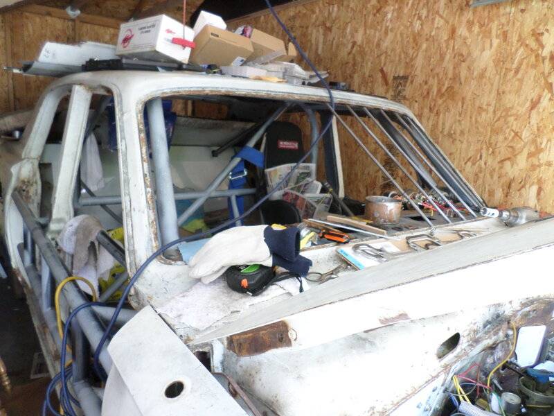

Robert, you keep asking questions about this thing.....I'm assuming this is still your dirt track car? We love answering questions and discussion but know what we love more? Pictures! How bout postin some pictures of this bad boy. We'd love to see it!
there ya go bro. side issues are a major distraction right now. RR
