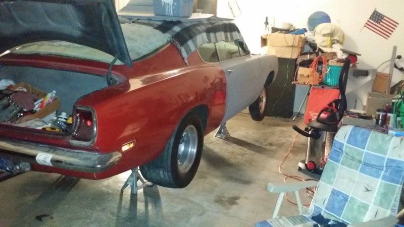

Prior to starting another Cubic $$$ project (65' Cuda Turbo 408) I rightfully so decided to take care of my neglected 69' that has been sitting out of site and mind in another garage. This (445 w/flowed Big Valve 906's/ 528 Hyd) was my 1st fast car and engine assembly build and to put the age of it into perspective, since I lived in So.Cal at the time. All of the Motor and Head Prep was performed at the now defunct DLI (Dick Landy Industries).I had started this reboot about three years ago replacing a fuel pump, rebuilding fuel lines, draining and cleaning a tank and got about half way thru the carb rebuild when my aging mom started requiring a lot of attention so there it sat. Mom left to be with the Angels July 4th of this year and I've been back in the swing of things for a couple of months now.

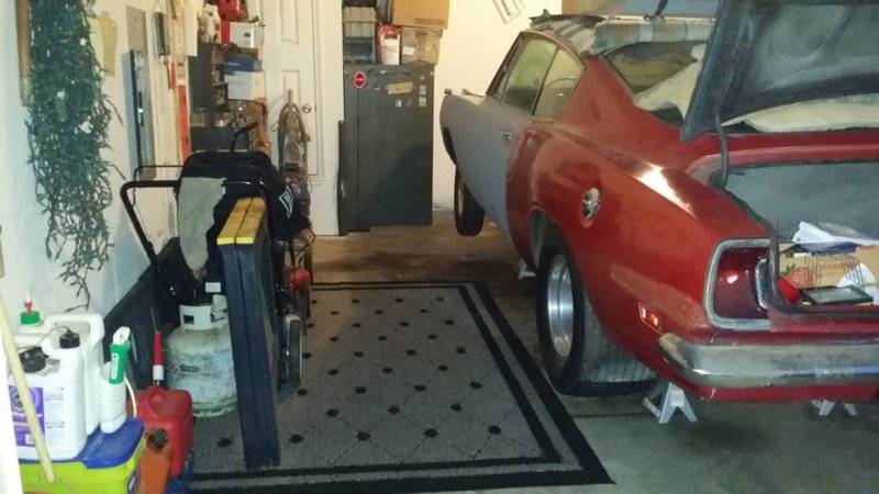

I finished the carb rebuild a couple of weeks ago and today got it up on jackstands, dropped the exhaust got that cleaned up and prepped for repaint (too windy to finish that today), shop vacked the arachnophobia like undercarriage, cleaned and organized the storage garage a bit (ALOT) and took inventory of what else was in need that I had forgotten about and of any new developments.
1) Well the radiator starting spitting coolant on the floor when I was jacking it up and I discovered it had some serious electrolysis going on so it's a likely candidate for the trash heap hopefully I can find another decent steel 4 core, if not a Griffin like Alum will fill its spot.
The old stuff I had forgotten was that though driveable the TF needed a rebuild, the 3000 stall converter's stator was history and that fkn old Chrome DC deep trans pan never ever ever, no matter how flat or what tightening sequence or combination or flavor of gasket was put on it was gonna fkn leak so it too may get replaced (WILL GET REPLACED).

My old lady said my manual disc brakes were too stiff and refused to drive the car
I believe a good radiator shop could fix that. Maybe not the core, but the tanks for sure, as long as they are not rotted all to heck.
I had a 1960 ElCamino years ago I was restoring. Bottom tank was shot, but top tank, and side brackets were good. I took it to an old timey radiator shop, and the guy had a nice used spare lower tank on a shelf. Sold it to me along with a new core. Try the old timey places. That lower tank may fit from many other Chryslers from that era.
I hear ya but look at this guys sign that's like straight outta the 1940's and the shop was pretty the same. Ya can't get a helluva lot more old timey then this place I took it to in Ft. Worth that has been there 4ever. It wasn't just a damaged bottom tank, the whole core had been pushed up towards the top and it just flat out wasn't worth fussing with at that point and I mean it wasn't like the best cooling radiator on earth anyway. Still dragging it around in the back of my truck for my penance, but as much as I hated too, I have long since purchased a Cold Case and two Derale Fans.
