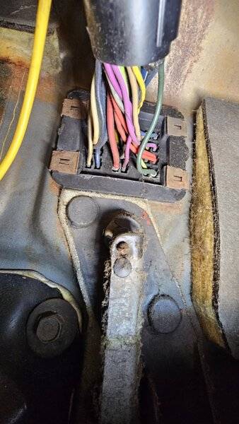

Long story short. I tried starting my duster from its winter slumber, and POOF it went up in flames. No idea what happened, either wires sparked or raw gas went up. I need the following parts... (please see attached)
There seems to be three wiring harnesses connected to the interior connector, I know one is the engine harness, one is the AC harness, but not sure what the other is! (help would be appreciated!)

Forward light harness I would think
Okay! Perfect. I'll take a look... the engine harness says it includes it but I didn't see the other connector for the firewall, could be a generic photo.

Since all that wiring is connected to the wiring under the dash through the bulkhead connector, I would hit insurance up for a new underhood harness from M&H and a dash harness from the same source. No sensing in patching 50 year old wiring

Sorry for the rant! Okay, so the inside wiring is actually fine!
Looks as if the connectors should come right off from outside the firewall and they'll need a good clean.
One of the harnesses connected at the firewall mainly serves the wiper motor, and that harness for a 2 speed motor (what you have) is also available. I missed what year the car is...
By the way there is very little wiring to the AC so it is an add on to the engine harness I believe
I think you're correct. the car is a 73.
